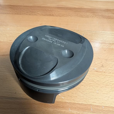

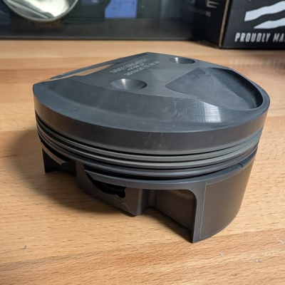

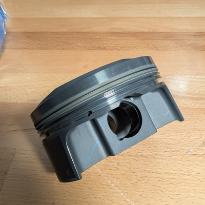

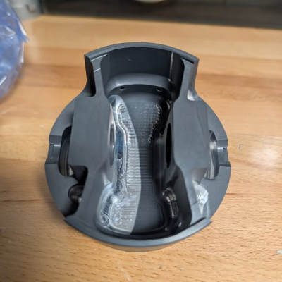

Modern Muscle Xtreme
2h ·
We have 3 Sets of custom Higher(er) Compression Drop-In Piston and rod sets available
14.1:1 Compression with OEM 6.4L Head Gasket and 73cc (6.4,6.2 or Aftermarket Head) - These paired with our custom drop in connecting rods are ready to make big naturally aspirated power!
Again, that's a no balance required 14:1 compression set of drop in pistons!
1 Set STD 4.090 Bore
2 Sets +.010 Overbore
Pricing- $2449 Shipped (Pistons, Rods, Rings, Clips, Wrist Pins)
These sets can be purchased via email only - email [email protected] for purchasing details.
See less
