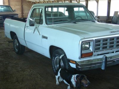

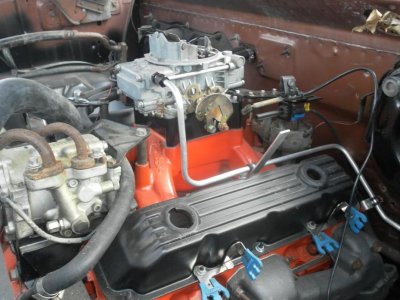

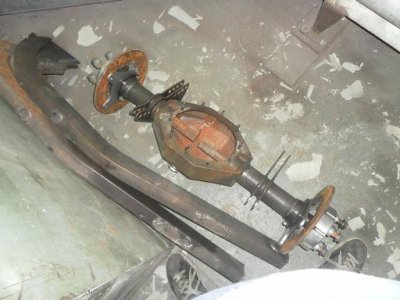

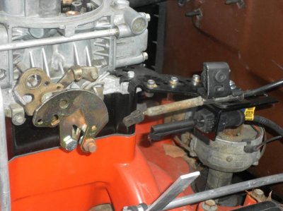

Here's a few pics! It's an 84 Prospector loaded out
Mods are as follows
98' model 5.9 Magnum
Edelbrock Performer RPM Air-Gap
2" spacer
600 Holley electric choke
Bouchillion kickdown cable kit
Bouchillion throttle cable bracket
92 model only large outlet exhaust manifolds & matching Y pipe
Cloyes Tru Roller timing set
Felpro gaskets everywhere
Factory serpentine drive using 92-93 only A/C compressor & lines
Factory aluminum radiator
Derale electric fan
Plumbed for FI
upgraded fuel pickup
#6 Steel Braid & aluminum line everywhere
Lowered 3" in the front with Dodge Van LCA's
Rear axle flipped on the springs
Alpine CDA-105
Still in progress
