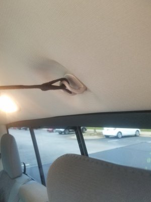

Yeah the hooks are located in a silly place, and it blocks your vision

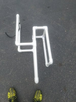

This is my solution in my 2017 Ram Bighorn. It is 1 inch PVC and fittings. There are 4 three-way 90 fittings, 8 90 fittings, 2 tee fittings. I also used three 23 in velcro straps to keep it in place and from shifting around. Two pieces cut at 17 in. Four pieces cut at 18 in. Five at 8 1/2 in. Two cut at 7 in. And two cut at 5 in. Four pieces cut 8 in. With the velcro no glue is needed you could add PVC glue if you desire.

Make up several kits with a nice set of instructions and I bet you could start selling those.

Anybody wants the kit let me know what you have a quad cab or crew cab. I'm also going to do a redesign that may be better for the quad cab. About $40 worth of material so I'll figure 75 bucks a kit shouldn't be bad.
