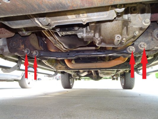

I had the the same clunking noise (as have many others) you describe, I stopped mine by tightening the four 18mm bolts on the crossmember that braces the rear lower A arm pivot. I tightened them with a torque multiplier until I was afraid any more would break the bolts. The clunking stopped, three days running, keeping my fingers crossed it is fixed for good.DSC01161rsz.jpg
