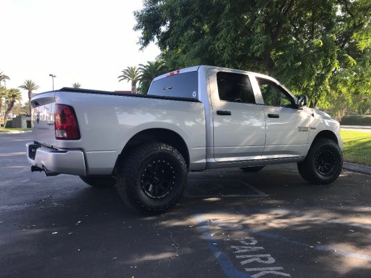

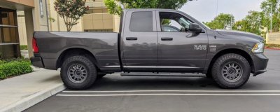

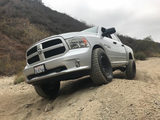

I did Rancho QL struts and Rancho rear shocks as my first level literally a week after getting the truck home. I put around 10k miles on them if i remember correctly. Plug and play nothing to disassemble from your factory struts. I still have those around, they're now my shock backup set. the stockers ended up in the trash and i've never looked back :)
Tires in the pics were Falken AT3W in 315/70/17 mounted on 17x9 -12 offset wheels. Running high caster courtesy of Zone UCA's. Zero rubbing on or offroad.
42334323440_48a87ce83a_k.jpgUntitled by RAM RSM, on Flickr

Also had my share of fun with them in the dirt. No complaints whatsoever
44430788991_47827761c8_k.jpg20180902_105719 by RAM RSM, on Flickr

Just added the Icon Stage 1 to mine. I like it alot. All of the local forests are closed now due to the fires but I will get it in the dirt soon. Here is my before and after.
