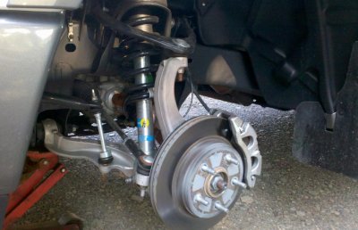

My opinion for leveling kit is the Bilstein 5100 adjustable shocks. Rather than put a spacer on top of your strut to achieve lift, you replace the struts with these ones. They run about $100 a piece or if you want to save money, there are numerous other leveling kits out there a little cheaper.
Installation for a leveling kit basically includes removing the strut, placing the leveling kit spacer on top and reinstalling. You'll need an alignment afterwards. As for the Bilstein 5100s, you remove the strut, remove the factory coil, then put the coil on the new strut and reinstall.

I attached a few pics of my truck with Bilstein 5100s with 35x12.50-17 tires before I lifted it, hope that helps!

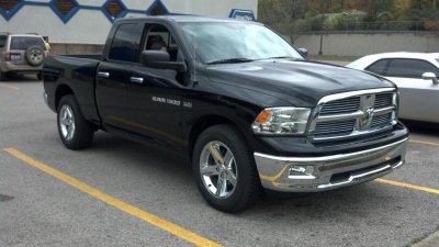

Included is pic of new truck and the last pic of the ford before i traded it in
Thanks everyone!

Good looking truck. Sounds like you'll have a pretty sweet setup with it leveled and some 34s!
