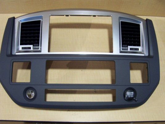

If you want a MOPAR unit the REC/NAV unit with 6 CD changer & navigation will fit. I did this retrofit to my 2007 Ram MegaCan.
I got this bezel from MoparParts:

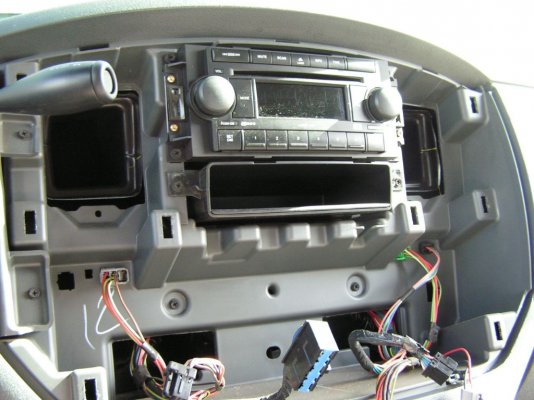

I got a REC/NAV head unit that had been refurbished online:
I got a Metra antenna adapter & a navigation antenna from Crutchfield. Both were installed in the dash behind the head unit.
I also purchased a REC/NAV maps DVD on eBay. That disc goes in teh slot between the volume and tuning buttons.
From there it was pretty much plug and play:

Lockpick adapter is to retrofit a MyGig unit. The RER is the ONLY head unit that friggin big to fit your dash panel exactly. Unfortunately it is quite dated, no map updates for a while (requires a nav DVD in it) and isn't touchscreen. Your choice lol.
