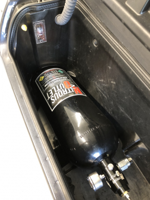

Bottle placement: So... I made it work. And, since we all love pictures, I'll throw some in of the install below.

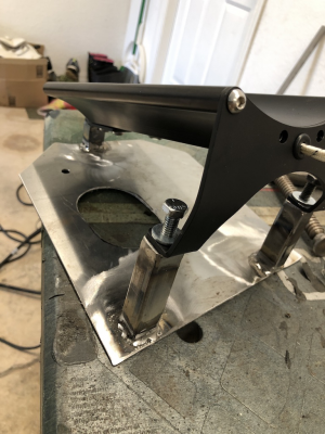

Made a custom bracket to fit in the RamBox, and cut a hole to allow it to fit better. Buttons (left to right): remote electronic exhaust cutout (up opens, down closes), arm (red light for on), remote bottle opener (up opens, down closes), heater (yellow light for on), purge (just cool blue ring around it).

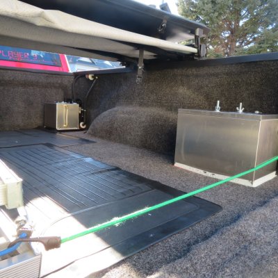

Front box is the fuel cell,rear box is the relocated battery.

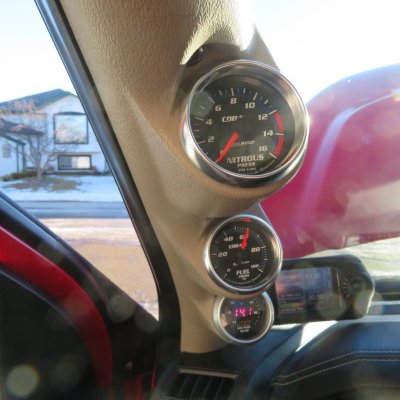

You do have a A/Fr gauge i hope,a fuel pressure and nitrous pressure gauge don't hurt,and wire it up with a fuel pressure safety switch,so if it looses fuel pressure the nitrous shuts off.
