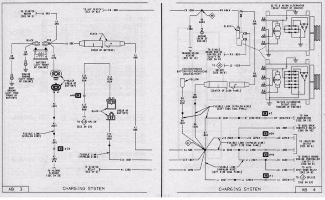

On my B250 there are several large cables from the battery that go above the engine to the alternator/starter, and are spliced into the various subcircuits near the brake booster. The color of the large cables is NOT A GUARANTEE OF POLARITY - a couple of black cables are actually +12v.
I've attached the pages from the manual for my van about the starting/charging circuits. You'll need the manuals for both vehicles, and a multimeter, as you'll have to splice the corresponding wires from each year's vehicle to each other (which may be different colors). There are two crap push-fit bullet-type connectors on the battery cables which seem to work loose and corrode.
I've started sticking labels on each wire so I know what circuit they supply - over the decades the original wire colors have faded so no longer match what is in the manual!

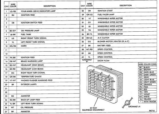

I'd get a 1982 MOPAR Service Manual for the D/W/Ramcharger -- invaluable info and a number of pages will be devoted to the 1982's electrical system. I also rely heavily on Power Probes to trace electrical problems -- great tool. The 1982 is very basic (no ECU) but those bulkhead connectors can be a PITA.
