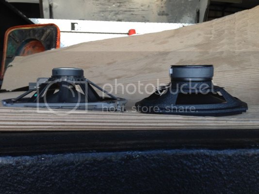

Stock front 6X9s on left, new Kickers on right.
Like others mentioned, you replace any one component and you get better results. And then you find it limiting. I'm going to install an amp in the new year.
