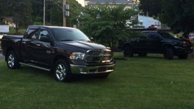

WURST1
WURST1
May 22, 2016
148
49
2015 Ram Laramie 4x4
Put my steps on tonight and Bilstiens are going on tomorrow morning.6076c825c09ddbaf93fffc34a01575ce.jpg
Sent from my SM-G900V using Tapatalk
