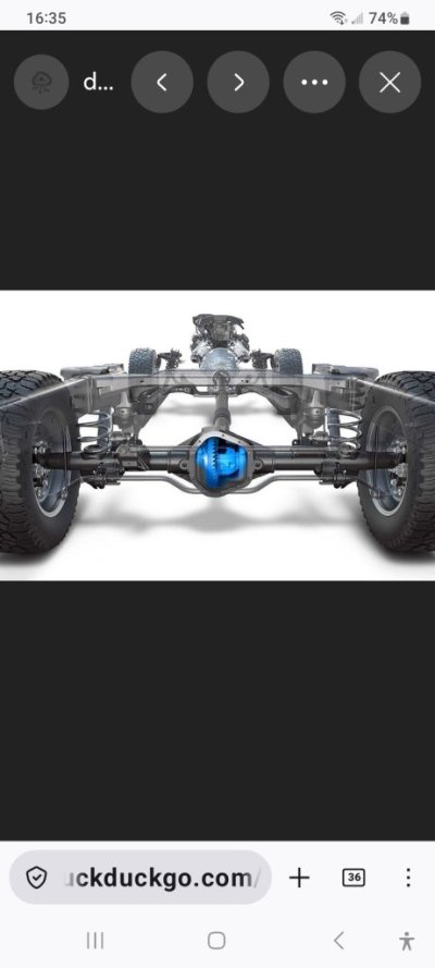

You don't need to measure. Wild is spot on. You can easily see it in the footwells. The reason the right tire spins on an open diff is that right side axle is just slightly longer and puts more torque to that side.
Notice how the diff is not in the centre, which accounts for the longer axle. You can also see the engine offset.
You're close,but it's actually the twisting motion of the driveshaft that lifts the passenger side of the diff Dean. The longer axle would actually apply less torque to the wheel,but the engines torque actually lifts that side of the diff,causing the passenger side tire to actually have less weight on it
