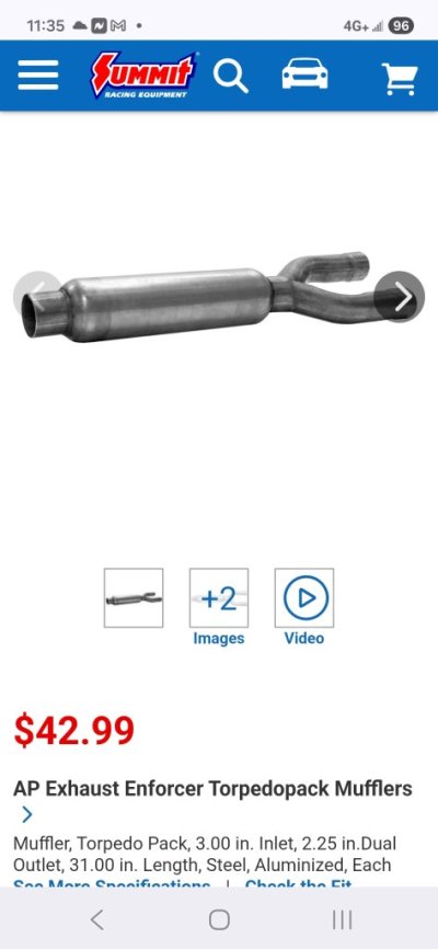

Here's the cheapest best sounding replacement muffler for a ram in my humble opinion. Don't need headers, pickup some noise for the neighbors and a few tens in mpg, if you can keep your foot out of it
About a 1.5 hour install depending on the state of your existing exhaust system
OK . If you're going for simple & inexpensive , with a " small , straight thru muffler w/ built in split for dual outlet " , dors the above really do anything significantly different from this ?
All you'll gain from a muffler swap is noise,it's not gonna give you any power that you can actually feel.The choke points are the log manifolds and the Y pipe. The trucks really respond to a set of long tube headers and a tune for the headers.
