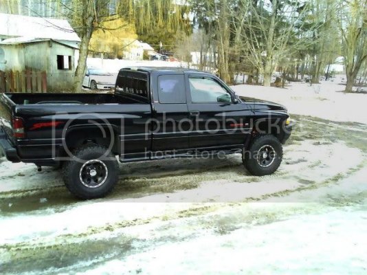

If they are the factory molded boards like I had you will be drilling holes, some in the pinch weld on the bottom of the rocker, and some others under the cab.
Got a photo of what you are installing?
Edit: Added photo

Yep, what you have/had.
Figured I would be drilling, just hoping not.

They are a nice running board, slippery when wet so careful there. If you need any help let me know and I can get some measurements for you if needed.
Edit: If you are lost for where a part goes just ask and I can help you out.
