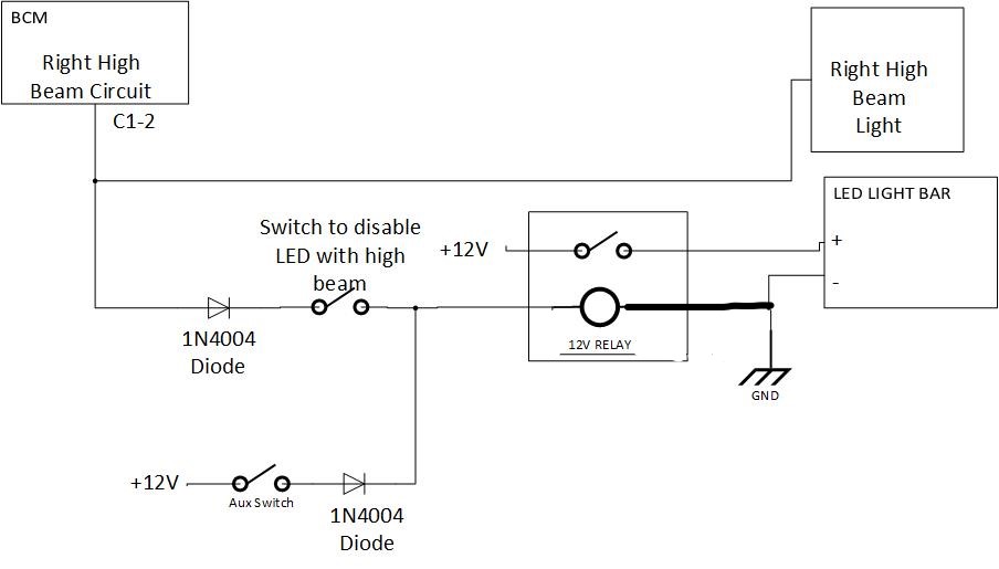

Body control module, it's under you driver side dash.
It looks like this...
And this is a basic circuit of what I did. I changed it up some but this kind of gives you an idea.
I can activate the aux light with the high beams or disable it by flipping a switch. I can also turn it on with it's own separate switch.
I eventually tied all this into my factory aux switch's with several other lights so mine got a bit more complicated.
I do not have the diagrams for a 2020 (mine is a 16 2500). I am sure they are almost identical but you might want to track down a 2020 diagram just to verify.

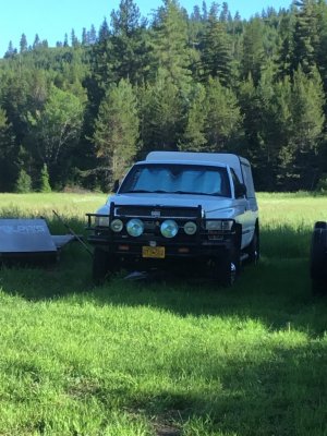

I have independent driving lights and will be doing the Sport headlight upgrade pretty soon. I would imagine all these newer automatic options can make it pretty smooth driving wise, but given location and use I prefer simple and manual as much as possible.09FA1A77-EDDA-47F3-ADEA-3E223779E036.jpeg
I routed an 8 conductor cable to the 3 round switches located up in the overhead console that control the relays (mfg supplied wiring harnesses) for the KC fogs, and the Lightforce moose lights= bright eyed and loud which keeps the moose running away...
