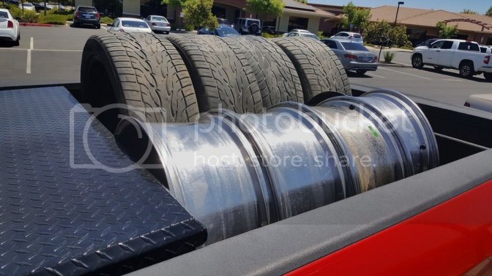

Busted the tires off the wheels to strip the wheels and paint and clear with a automotive paint through a proper paint gun no rattle can BS. I'm still going to do the Semi Gloss black with red ring on the lip.
Now just waiting for this new tool to arrive, it will be a tight squeeze but I think they will just barely fit.
Eastwood Abrasive Blast Cabinet

Sweet! You doing the paint work yourself?
I do paint work and love doing silly little stuff like this. Don't be shy on the clear and make sure you let it flash a bit longer than what the product you are using calls for. This will ensure a good strong/clear clear.
