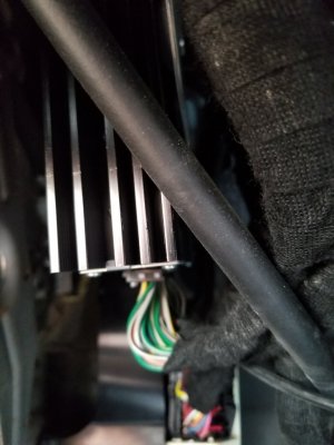

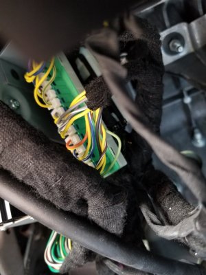

Trying to avoid tapping into the trunk signal wire under the hood. Any idea what wire under the dash on each side might correspond to the turn signal wire coming from the outside power mirrors? Here are some pics of drivers side connectors in that vicinity but sure dont want to try each one to fine it!! Anyone have any ideas?
Apr 27, 2019
86
62
19076
5.7L V8
My truck is been getting some work done in the shop and I get it back today and I will take a picture. But again I went into the dome light wire Which I'm pretty positive was purple with the yellow tracer. But Hello also take a picture where I believe they tapped into the turn signal wire
Sent from my SM-N950U using Tapatalk
