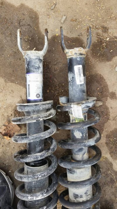

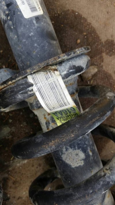

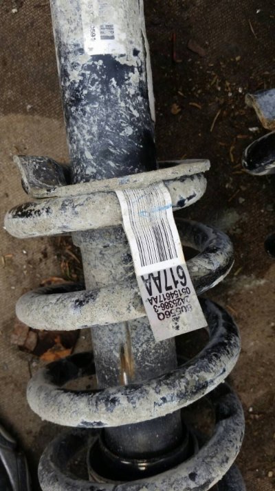

Well put the bils on my outdoorsman today, since i had a pair of stock 13 sport shocks on the shelf i figured id take advantage and compare them to answer everyones questions on wether or not they are different. Well they are the same total length but both the shock body and the springs have different part numbers, the lower spring seat sits close to an inch higher on the outdoorsman vs the sport
Old spring
New spring
Side by side
