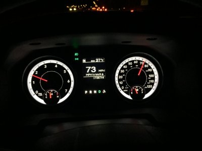

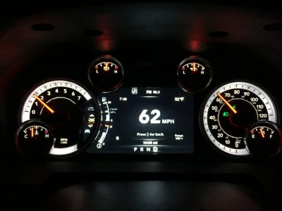

Premium Cluster Upgrade done in twenty five minutes!
almst791
Nov 29, 2016
46
All credit goes to cody4130.
Purchased the 7" Premium cluster from ebay with right around my mileage for a decent amount of $. Comes with a lot more functionality and hey its prettier:crazy:
Followed this posts instructions
http://www.ramforum.com/f75/how_13-14_premium_cluster_upgrade-54797/
Everything was pretty simple except getting the actual cluster turned correctly to get my hand behind it and unplug the harness, also do not just yank, there is a little clip on top of the harness.
Turn on car before screwing everything back in to make sure cluster works, everything syncs up, you just have mileage from new cluster and engine time is from new cluster.
Hardest part was getting harness to reach back into cluster input, you just have to turn it a weird way and get the plug in then rotate it into its normal placement.
Love this add on so simple!
