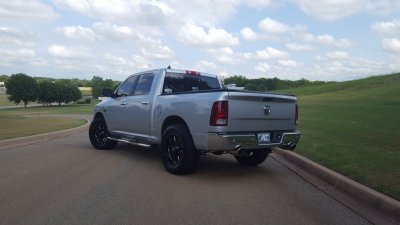

On my level, I did a 285/65/20...about 34.5" tall

295/65/20 is about the biggest. I ran a 285/65/20 and it filled the wheel well nicely without looking stuffed.

They were 20x9 with 0 offset
