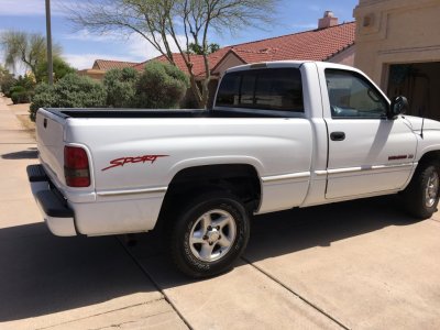

I am about to buy a super clean, ‘98 Ram 1500 Sport 2x4, single cab with only 64,900 miles. It is in perfect condition with only a few issues. (like a door lock not working) I was wondering if anyone could tell me some pros and cons/problems that I need to look out for, so that I can keep this truck on the road for many years. Thank you

From there, I'd just drive it. Thing looks like a museum piece.
