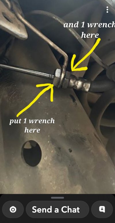

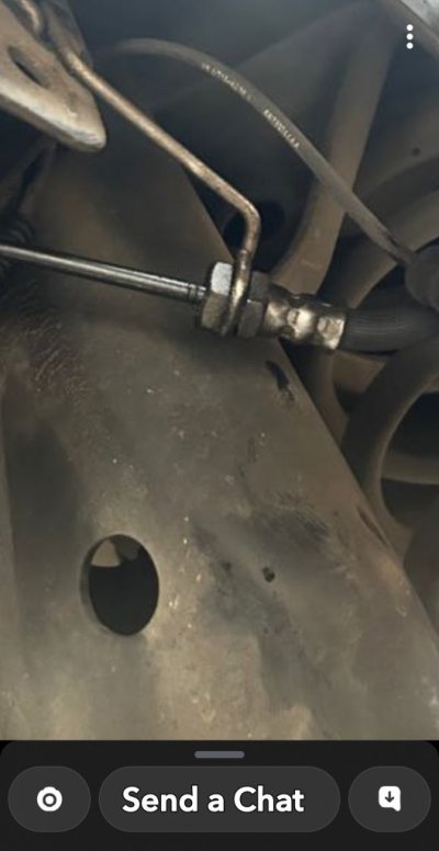

Rear passenger side brake hise replacement-2014 ram1500 2wd where the hose meets the metal...im not able to get that apart to replace it. Help??

Is it supposed to come apart? Or am I supposed to be replacing the metal piece too at the same time? The videos I've watched shows it being unscrewed and just replacing with new and voting back up

Where the black meets the silver...I know...I'm not a mechanic but really need help with this asap. Thank u in advance

Hopefully you figured this out, but you just need to take these apart at the two nuts. The metal end connector is part of the rubber hose. Be prepared for fluid to come out, have the new hose ready and obviously make sure your master cylinder is full before and after the job.
Here's a video with some good tips about cleaning the threads first and so on, it also shows removing them pretty clearly.
https://youtu.be/V2q4aAfuRRc?si=OnYGqzuHvfW4CbLS
