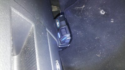

Amazon. That's were I got my adapter. After that it's plug and play. Pending how much you use your brake controller (i don't use mine much) I mounted mine low on the dash in a pre drilled panel so I didn't have to drill into my dash. I can still reach it Easy but it's uncomfortable.

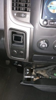

This is where mine was, too. I ended up buying a Hopkins Flex Mount, put the display in the cubby hole, the controller in the ash tray, and the proportional module behind the dash.
