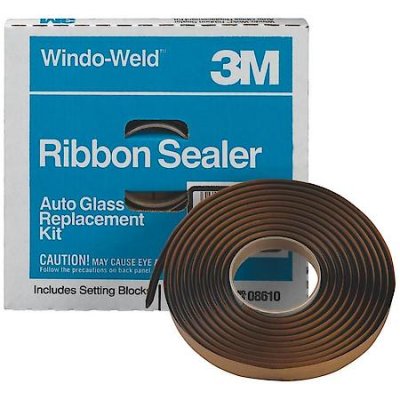

I used this tape on my heads and it did ok but I wouldn't use it again. If I do my other set I'll use black or clear silicone like i did on my taillights....much easier to work with...IMO
