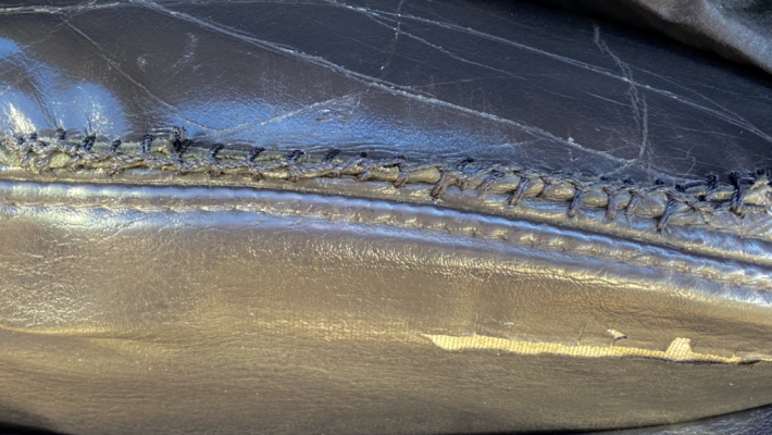

You know... That ripped seat on the left side that you see every time you get in or out making you feel sad.
Well, just sew that sucker shut.
I lined the underside of my rip with gorilla tape so I would have something more substantial to sew / pull on and used an upholstery needle and some nylon cord used for tying a peep sight into a bow string.
You'll need needle-nose pliers, but the rest our grandmothers could pull off.
Just DO it. LOVE mine now and don't get a sad feeling every time I get in and out.

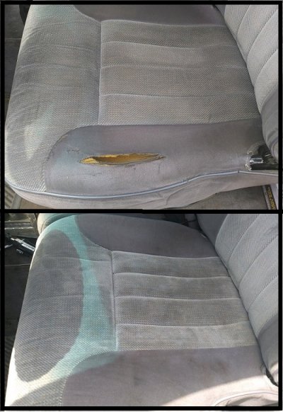

Before and after of my seat repair and a link to the write-up I did, describing using a pass seat bottom on the drivers side.
