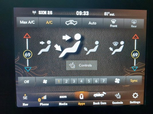

I dont know if this truck has "Max AC" like the old one did. Its got the electronic temperature settings. You dial up the temp you want and its hot here. We are in Alabama so I normally have the ac on as much as I can!
Check the Climate Controls on your radio.
This is the Uconnect 8.4C on my '21 Warlock;
If you can't locate a MAX A/C setting, set the HVAC circulation control to recirculate, AC enabled, and crank the setpoint as low as it will go.
Either method will cause the E-fan to run immediately and until you either change the settings or shut off the engine. :cool:

OP when you hit climate control look at the top menu bar and the top menu bar you will see the words MAX space AC hit that button on the Uconnect and your truck will be in max AC and the temperatures were all go from reading a number to the letters LO for low. Look at post number seven this thread at the top left corner and you see the max AC setting there that you hit if you want Max AC on.
