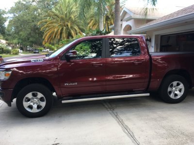

Installed Rough Country 2" leveling struts the other day. Greatly improved the stance and look of my truck.
Will be looking to upgrade tires soon and would like to keep my stock 18" wheels.
Has anyone else done this? I'd like to go to a 34 or 35 inch tire without any rubbing issues.
If anyone else has done this I would greatly appreciate any guidance.IMG_2560.jpegIMG_2561.jpeg

A Toyo 285/75R18 AT tire is 34.8" tall and 11.2" wide.
Those should fit on a stock wheel with no problems as Toyo lists them fitting on wheels from 7.5" wide to 9.5" wide.
Given the stock wheel offset you might experience a slight rub at full steering lock.

Thanks for the reply. I have seen several tires on different sites in that size. My stock tires are 275/65 R18's which are basically 32x11's
Most of the 285's list as 34.3-34.8" range. I have looked under my truck with the wheels fully turned and another inch looks like it would be fine. I was hoping to hear from guys that had actually done it before I pull the pin.
