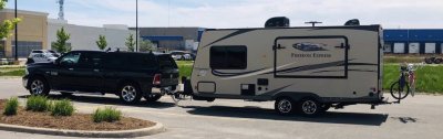

View attachment 173594Our coachman and truck. Steel have to deal with the back sag.
I have a 24 foot bunkhouse. GVWR is 7,000lbs. I had some sag too. After properly adjusting my WDH, I added Airlift 1000HD in coil spring bags. What a difference. No more sag or porposing. Hellwig sway bar was also a great mod for towing.
Sent from my ONEPLUS A6013 using Tapatalk
Did you install the airbag or have them done. I did raise on hole on wdh. And have not tried it in the trailer yet
Do you also heel the air bags on pressure all the time ?
Yes, it's an easy install. Lots of YouTube tutorials. But you just need a couple of hours and basic tools. I leave about 5-10 pounds in them a the time. 35-45 pounds when towing the TT.
Also, watch some videos on how.to setup the WDH. Getting it right makes a huge difference.
