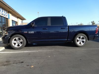

Did the GF 2/3 lower on our 13 Ram CC 4x4. Tried the ram model airlift bags and they were too long. Granted they held up for a cross country drive but i later replaced them with bags for the explorer. They are about 2 inches shorter in height and fit much better. Ill try to attach a pic tomorrow when the suns out.

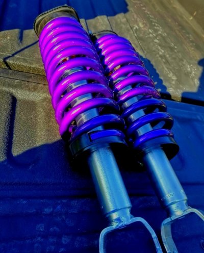

I’ll sell you a GF 9984 kit that’s been installed for a week. I got different Struts/Shocks (Rancho RS7000 with a shorter length than OEM rear shock to give more stroke from the drop).
Powder coated Prismatic Powders “ILLUSION PURPLE”
I even have some ILLICIT CUSTOMS no cut brackets never installed I can sell too... 94b2e863f0c87b62347eb7bddec6f50b.jpg

Apologize about the explorer bags mention. Got 'em confused I have the durango bags. They def help with towing. Recently used a moto hitch carrier with a zx6rr (430'ish lbs) aired the bags to 70psi and had no issue. Forgot to air them back down when complete and it was like a log wagon when i hit a bump. Excuse the dirty dirty on the truck but i took a spill at thunderhill raceway on the moto last sunday and my ribs are still feeling pretty not awesome.
