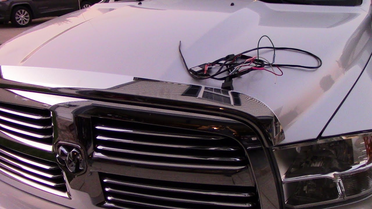

For anyone that co.es across this heres a video of a guy that found the device and the removal of it. They vary in installation. The one in the video they butchered the harness. The one I found was plug & play through the OBDII port.
