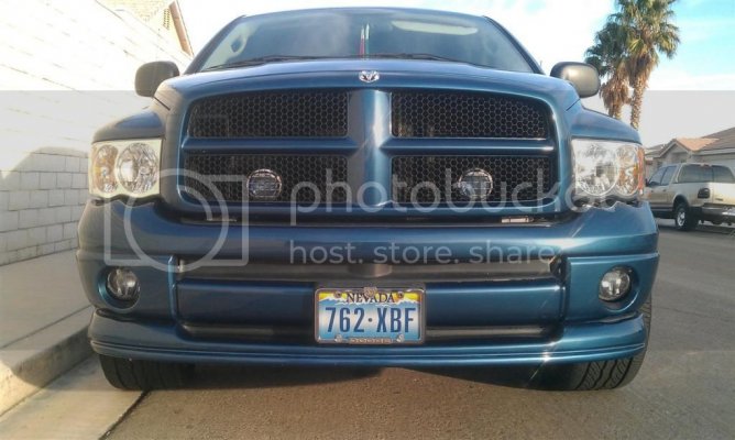

sport over chrome

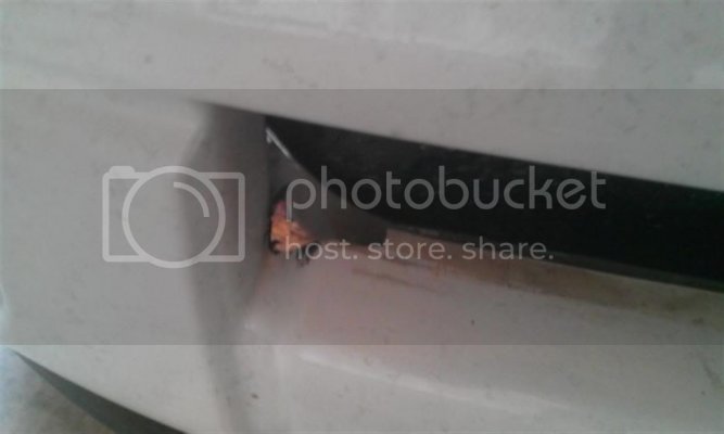

just trimming of the cover

and here it is finished. Just the couple places of trimming, and then the insert covers that so you don't see it anyways
when you say trimming, do you mean the back of the cover? and with what? lol
i really wanna do all this.
and did he take the upper bumper bad off for the install and just leave the chrome?

Yes the upper part comes off the chrome bumper becomes your support.
In the first pic I posted it shows what he trimmed on each side of opening above the license plate.
