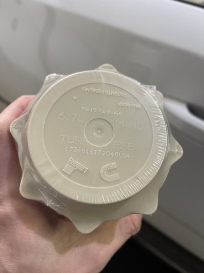

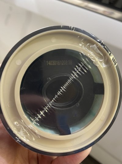

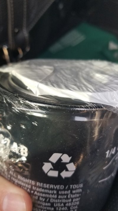

If you can post these 2 pics. This is an authentic filter. Compare the depth of the plastic piece. But also look at the printing of the Recycle symbol. Does it look "off" in comparison? Also did you get your filter from a seller on Amazon? That's where the fakes (or defective)
have been coming from.
Really appreciate you sharing this knowledge and picture. Will be doing my filters soon and knowing what to look for with this counterfeit issue is good to know. Thanks again!

I got a set of counterfeit from Amazon the seller was Woot. I didn’t use them getting money back. The whole reason I buy OEM filters is to avoid issues and damage to the system. First two pics I took. The third pic I got online as I didn’t have the knockoff anymore. I bought the oil filter, water sep, and fuel filter deal on Amazon.
