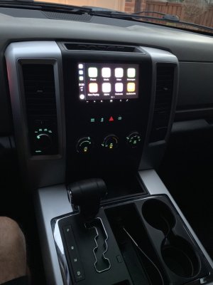

I went with the Alpine ILX-W650. It is a fantastic head unit. It’s only 2” deep and loaded with every feature you need.

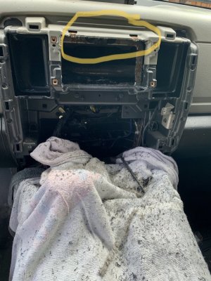

I did have to trim a small piece of the plastic lip. It was about 1/4” straight across the top plastic surround. Easily done with a dremel. You do not have to do cut the rear metal bracket.

Thanks for the info & photos
