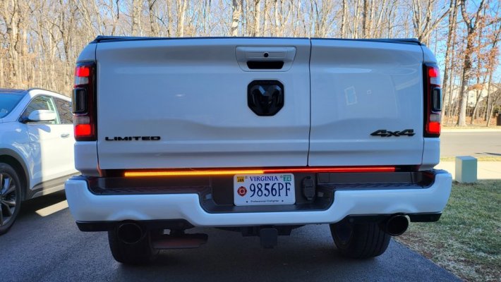

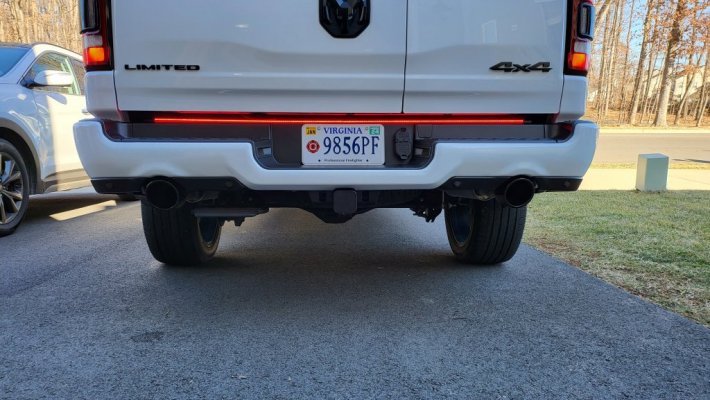

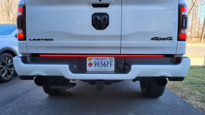

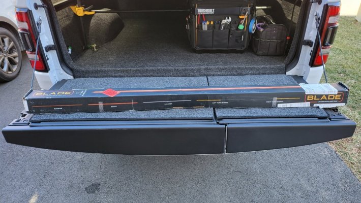

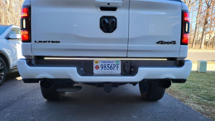

I did the putco blade comes with mounting hardware that uses 3m tape, also purchased the putco trailer Connector that plugs in behind bumper, very easy install took less than 30 min20220209_135805.jpg20220209_135732.jpg20220209_135609.jpg20220209_135523.jpg20220209_135314.jpg
