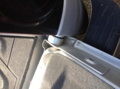

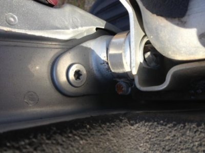

I don't know if everyone already knows this, but I have a tip for those who cannot lock their tailgates. A cheap hose clamp placed around the right hand side hinge pivot point will prevent the tailgate from being lifted off easily. The ones I have put on in the past I ground the screw head on the clamp off so it cant be unscrewed. It isn't in the way and is barely noticeable. Hope this tip helps.
