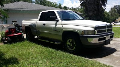

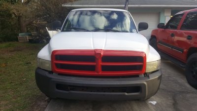

The truck.... wellllll.......

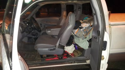

Aside from the broken and missing dash, the rest of the interior is actually in really good shape.
But the outside... yeah... years of neglect have caused the clear coat to burn off. Paint is wearing through to the primer in some places... to bare metal in others. The passenger side has damage from one of the other previous owners turning too sharply and side-swiping a metal pole. You can see the shoddy body repair attempt in the pictures. The rear bumper has been hit as well and is sagging and has a dent in it... it was apparently pushed into the bed because there's a dent in the lower bed quarter from it. On the driver's side bed quarter, you can see where someone snagged something because that panel is pulled out a little. The plastics are faded and sun-damaged, the tail lights are perfect, amazingly, the headlights are fogged up, cracked, and yellowed, and the chrome is peeling off the grille.
The truck smokes like a chimney, runs so rich it will choke you out, has dual exhaust with no muffler or cat, no heat, no ac (which to add insult to that injury - manual windows), none of the factory speakers work (so the guy I got it from put computer and surround sound speakers sitting unsecured in various places), and the deck just flops around on the dash, and the window tint on the front two windows are bubbled up and faded.... almost like whoever tinted it didn't know a thing about applying tint and instead of having it re-done, just left it that way.
Aside from that - the frame and underside of the truck is rust-free. The transmission shifts smooth and the motor fires on all 8 and idles pretty decently for the amount of oil it consumes (about a quart every fillup).The exhaust sounds great with the windows up... but sounds like a trashy redneck truck with the windows down. Other than the trouble areas I had mentioned before, the rest of the body is pretty straight. Few dents and dings... nothing a little massaging and body filler can't handle. And hey, it came with nerf bars and a fiberglass bed cover with good gas struts.

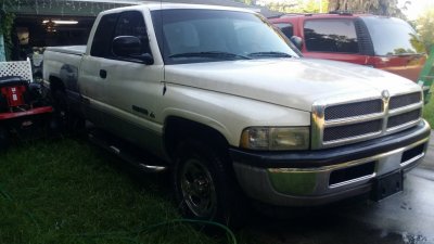

Hot mess aside, I was in love. It was nice to have a truck in the driveway.
But uh... yeah it needed a wash really bad. Truck was literally growing algae. Guess they parked it under trees a lot.
Doesn't clean up all that great... but it looks good wet. And hey, no more algae!

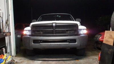

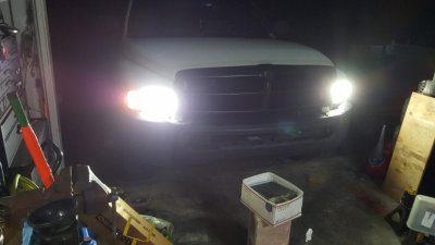

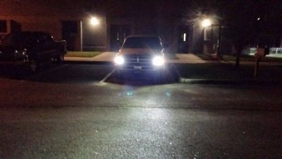

First thing I noticed was that those headlights were nearly useless. Didn't have money for new housings and most of the sun damage was taking place on the inside of the lens.... so restoration was futile.
So I bought a pair of LED bulbs that were much brighter than the halogens and threw 'em in.... helped quite a bit. At least I can see at night now.
Almost forgot... the LED bulbs are Hikari's that I got off of Amazon at a pretty decent price.
Shame that they won't work with my new housings, but I'm going to hang onto them in case I go a different route.

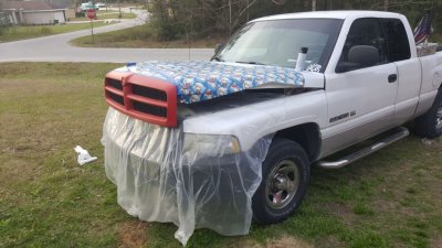

Hurricane season came along and we had a couple of pretty big whoppers last season. I loaded up the back seat of the truck with all my ready gear and prepared for a few days worth of being locked in the comm center (I'm a 9-1-1 dispatcher, btw).

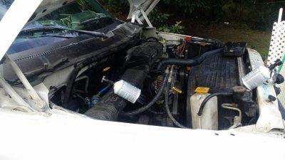

Didn't take me too much looking around online before I discovered the plenum pan gasket issue. Figured it would be best to take care of that right away. The truck smokes, so chances are it would be a good idea to change it out. Turns out there was a decent amount of oil in the pan... but nothing too alarming. Oh well... it's got a brand new fel-pro gasket with new shortened bolts to keep a more consistent gasket compression and not break apart from vibration now.
Had to take a pic during beer:30.
I replaced the AC compressor while I had everything apart, drove it to a shop and had him suck it down, then filled her up with some r134a. Ice cold AC finally!
Oh by the way... at this point, the truck still smokes like a chimney.

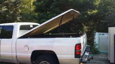

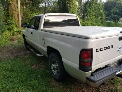

So this tonneau cover thing.... uuuhh.... yeah... fiberglass.. eeeehhhhhh.... if some of you like it... well... good for you... not a fan.
Sure it's probably handy for some things. Definitely keeps things dry. If you don't use your bed a whole lot or don't haul large objects... I could see where people would really want one. But uh... yeah I just didn't like the look of it on the truck, and I needed a toolbox more than I needed to keep things dry. Figured if I want to keep something dry, I'll just fold up the rear seat and throw it in the back... or tarp it like I used to do with my old trucks.
I had a tonneau cover on my '03 Dakota, but it was a LiteRider Roll up cover and that thing was GREAT. Kept things dry, looke good, didn't stretch, shrink, or distort, and would fold completely out of the way allowing full access to the bed when you needed it... but it is also expensive... about 3 or 400 bucks depending on the model. So I just nixed the idea of a bed cover altogether for now. Just don't need it.
Listed the tonneau cover for sale for about 150 bucks and sold it a week later.

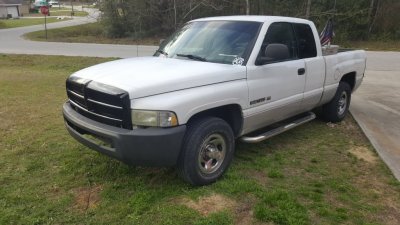

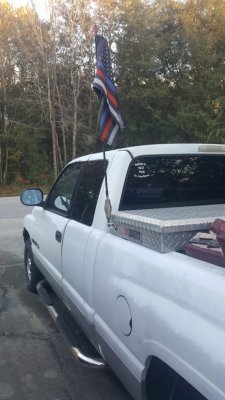

So I was fartin' around on Facebook one day and I came across a listing for a truck toolbox. Forgot all about the facebook marketplace, so I started searching for more toolboxes. Found a guy nearby selling a Tractor Supply (re-branded delta) toolbox with good struts and keys included for a hundred bucks. Couldn't pass it up...
The toolbox had a mount on it for a CB antenna, so I through my antenna on that had my foreverwave flag mounted to it....

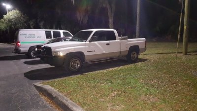

One of the FRTC members posted up a pic of his truck wanting to see if anyone was interested in a sport grille and 4th gen bumper. Said all he wanted in trade was a stock chrome grille and bumper in good condition.... well I had just the thing for him!
So I drove 2 hours down to Orlando after work and we swapped everything out real quick.
And I mean REAL quick... didn't even bother to align everything. Just slapped everything on and torqued it down so I could get home and get to sleep for work that night.
A few days later, I noticed the passenger side looked like it had been snagged on something. So I pulled out a block of wood and my 3 lb hammer and went to town. Can barely tell anything is wrong now.

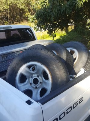

I'm not a metal scrapper by any means, but we're moving to Kentucky in July and we have a bunch of junk around the house... well... by "we" I mean "I".... so I gathered together anything that was metal and tossed it in the bed of the truck (and the cab of the truck) and headed to CMC....
Didn't do too bad. Hauled over a thousand lbs in her without much notice. Man I love this truck!
Hey, 70 bucks I didn't have before and now I have room to move around in my garage! haha

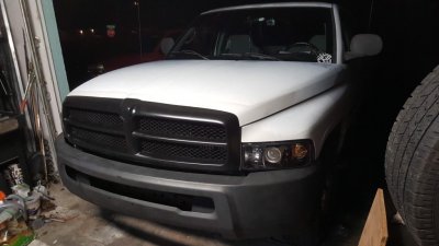

So the more I looked at the front of my truck with that red grille on it, the more it reminded me of this:
Yeah, that's gotta go. Rustoleum satin black to the rescue!
I was a little worried at this stage. Was still pretty glossy.... way more glossy than I intended.
Whew! Dried to satin... perfect. Bumper is next.... I'll probably do the lower rockers in gloss black to cover up that silver. The chrome nerf bars are getting the bedliner treatment eventually too.

Noticed when I was walking out to the truck one day that I was missing a corner lens. Crap... must've fallen off when I hit a bump or something. Good thing I had some extra money coming up in my paycheck. Ordered a set off of amazon with free one day shipping.... gotta love that Prime privilege!
So here's what I started with.... super bright LED bulbs that didn't get much distance due to the milky lenses... funniest part is, the headlight lenses fell off on both sides when I was removing the housings... guess they were next to go!

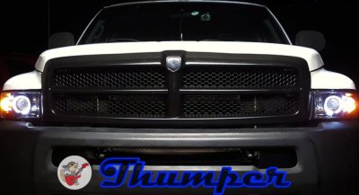

One of the things I was wanting to do was paint the radiator support and evertyhing else behind that grille BLACK... because that white peaking out from behind everything was buggin' me. So, while I had everything off, I hit it was some flat black.
Turned out pretty good.
Now for the headlights....
Much better. And with all those components under the hood painted black, your eye doesn't automatically go to the glossy white paint peaking out from behind everything. I made sure I took the time to line up the bumper with everything while I was at it. The fit is MUCH better now. I still have to tweak the fit of the grille, but it's definitely not as noticeable as the bumper was.

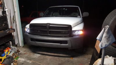

Here's the modes of the headlights. I wired the LEDs and the halo to the parking light circuit. I'll probably wire them to a separate switch later on, once I figure out what I want to do with them.
Parking lights
Low beams
High beams.
