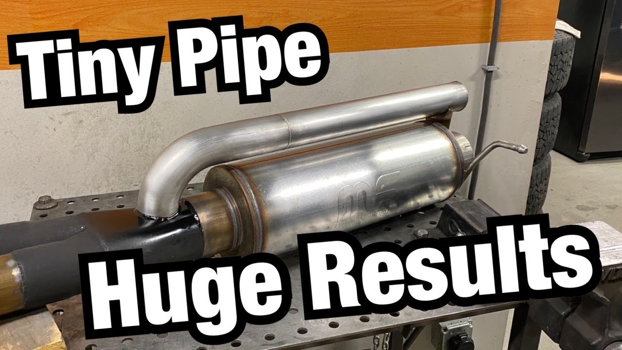

Man, that's a lot of effort, but I think you've missed out on the biggest possible drone cure. I really like this guy in the video below, I've watched him for many years. If I had a serious drone problem, I'd absolutely be following the instructions in the vid. I would have used a trombone style j-pipe, i.e., with an adjustable length piece of pipe, secured by a band clamp. That way the frequency could be tuned perfectly and easily.
