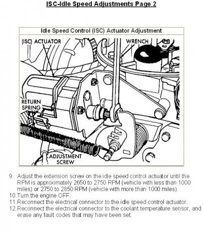

i don't think they have a IAC. i think they got a ISC motor instead and this is how you adjust it
