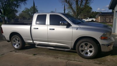

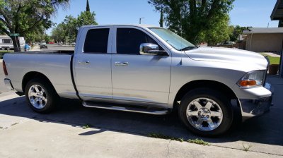

I'll have to take an after picture tomorrow. I have a before but I'll post them together on my post tomorrow. I'll put up the before for now to let you see how low it was before. In regards to lowering, I use my truck a lot and I'm always hauling stuff. I need the payload/clearance in the rear so lowering was out of the question for me. Thanks for the recommendation though.
J
J.Mar12
Apr 17, 2017
Here is a before and after of the lift coils. It's a little hard to see the space between the top of the tire and the bottom of the fender in the after picture but as you can see, you cannot even tell that the rear is 1.25-1.5" higher. I'm not a fan of the running boards that have been on the truck since I've bought it but in my case, functionality beats aesthetics. My wife is 5'2" and cannot get in without them. Let me know if anyone has ideas on another set that doesn't stand out as much.
