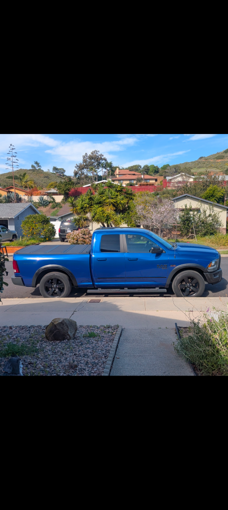

I leveled my 2019 Warlock RWD with these and somehow it seems like side to side sway INCREASED. Is that possible? What can I do now to "tighten" it up? I'm happy with the look at least
(I had done this same thing to a '17 Big Horn and don't recall any issues at all)2470.png

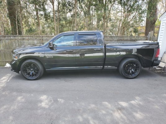

100% inaccurate. It is 100% noticeable from others and I was constantly complimented anywhere I went and I drive all up and down east coast and out central. The ride is far better than stock, far more stable when reversed level and there is nothing wrong by doing so. Just because someone has issues with a modification doesn't mean the only solution is return to stock. They dont do the rake for aerodynamics they do it for tow/haul when a load on the rear to do exactly what the reverse level lowering springs do.... and thats to increase the stability and ride comfort when loaded in the rear... just saying...
