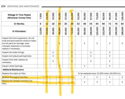

Was told that the fuel filters are required change every oil change. Was told that from dealer service department. Must be location specific on costs as have read other places are less expensive. I changed dealers on my last purchase so will ask what they charge. If a bit cheaper, may consider going back to diesel if I ever upgrade. But unless Ram changes to at least a 8 speed, may consider GM with the 10 speed. Every person I have talked to that owns one states it’s a beast pulling 15,000 lb rv’s.
You were lied to. The fuel filter on the 6.4 isn't even an item to check in the Maintenance Section of your Owners Manual. On the diesel, it gets changed every 24,000 miles.
I guess if you want to play it safe, you could change it every 3 oil changes.
Bearcatrp
Jul 22, 2014
230
173
So, with that chart showing 15000 miles, I was told right. Correct? Oil changes for diesel is every 15000 miles from what I was told also.
Yes, oil/filter and fuel filters yearly or 15K, which ever comes first.

I do oil/filters at 15k and fuel filters every other oil change (or every year, whichever). That aligns pretty well with the EVIC. Of course fuel filters will depend on the quality of fuel you run. Sometimes they may need changed more often.
The manual and service dept say every oil change, but if you'll watch the EVIC you'll see that you will change filters often with over 50% life left. Totally your call though.
Stick with the OEM filters (Mopar/Fleetguard). Aftermarkets have been known to cause problems.
Talking about the diesel engine.

Yes... for the diesel oil changes are every 15k miles. I still think their chart for fuel filters is a bit of an overshoot. It certainly won't harm the engine changing them even more often, but it sure will hurt the wallet for no reason.
