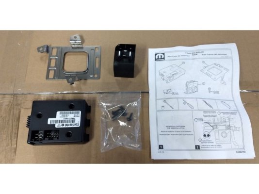

2019 5th gen or 4th gen classic? Assuming 5th gen since posted here but all 1500, 2500, 3500 and above use the same one 68309259AC which is the physical switch itself. Other parts like the module may be needed and may differ between the 1500 and HD's. Then of course programming is required.
Known part number for the 1500 controller kit 82215278AF gives you the module and switch.

here is the kit 82215278AF fits all 1500's 5th gen DT 2019-2024
