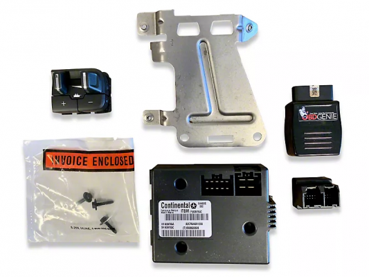

I have a 2020 1500 Classic that I want to install a trailer break in. The only real issue that I'm having is programing the CPU. to be specific, its gaining access the bypass gateway to install the module to allow programing. Anyone out there who has done this? tips and pointers welcome. FYI, i do know the location of the gateway but getting to it is a real pain,

a little more information could be a help ! like what are you using to program the BCM ! ALFA obd with the security bypass cable ? or some other program ? and have you got the brake controller module installed already?

the brake controller is installed, to program the truck CPU I have a geni OBD programmer and the gateway bypass module. to use the geni you need to install the bypass which is my issue.

This looks like a package from infotainment.com? Have you contacted them about your issues? I'm sure they would be helpful.

Plug in the bypass module (under the steering wheel) it's about a 3"x5" module, has 2 connectors in it that go in to the bypass module. Plug the Genie in to the OBD port and follow whatever instructions Infotainment gave you.

on the 2020 1500 classic it is behind the LCD display but not easily accessible even with the display removed
