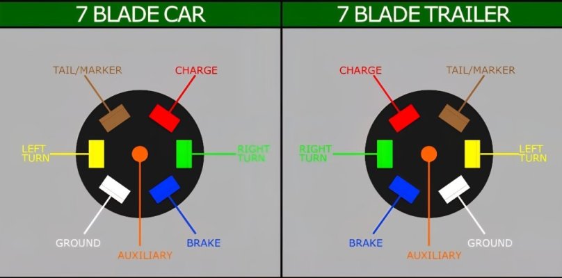

Trailer seven pin male wiring diagram?
Dave Mason
Mar 5, 2018
8
14
BC, Canada
1997
5.9l Cumins 12 valve
Anybody know the best diagram for the trailer plug on a dump trailer. My ‘97 dodge 3500 is fine but the trailer functions are mixed up. I’m installing a new 7 pin connector on the trailer.
