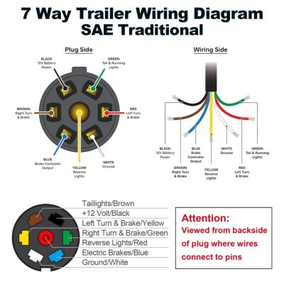

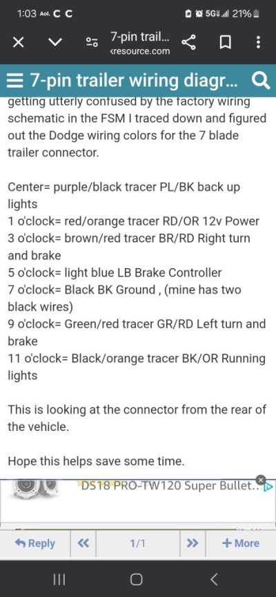

2 to 3 years ago my truck got rear ended, luckily it just gave my back bumper a duck lip and smashed my trailer plug to pieces. So i kept researching diagrams for the trailer wiring cause none of the colors made any sense but i found 2 forms showing what wires work with each other.712D8QEOOYL.jpgScreenshot_20240711_010303_Chrome.jpg
I hope this helps anyone, it worked for me even my brake wire works
