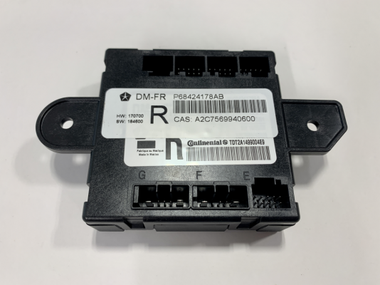

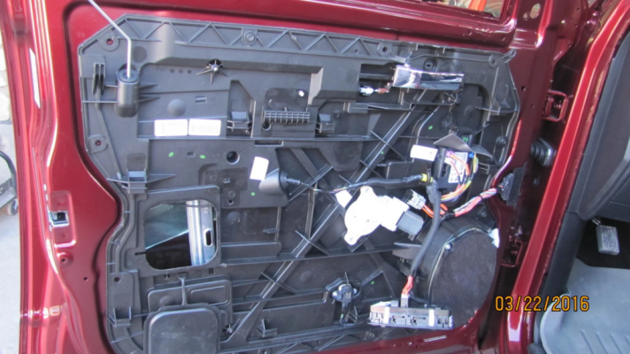

you may also need the door modules to go with the mirror upgrade
They have the basic door module
the door module that has power folding, puddle lights, etc.
You have to discover which unit your Ram currently has in it.
Then if you have to replace the door module, it will need programming.
You can do that yourself, or use the dealership

You shouldn’t need a door module, just Alfaobd. Mines 10 years older but also an slt and all it took was enabling with Alfaobd.
