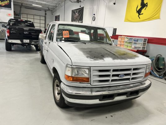

The only way to get it off is park in the shade. Preferably the garage and use lacquer thinner. Trust me on this one. IMG_0724.jpegIMG_2885.jpeg
