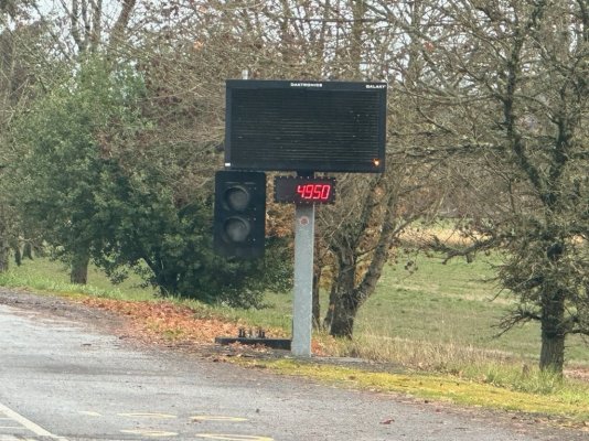

My 22 with 6.7 Cummins, six speed trans tips the state scales with 2/3 tank fuel at 8250 see my photos below...
