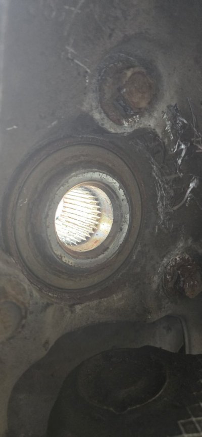

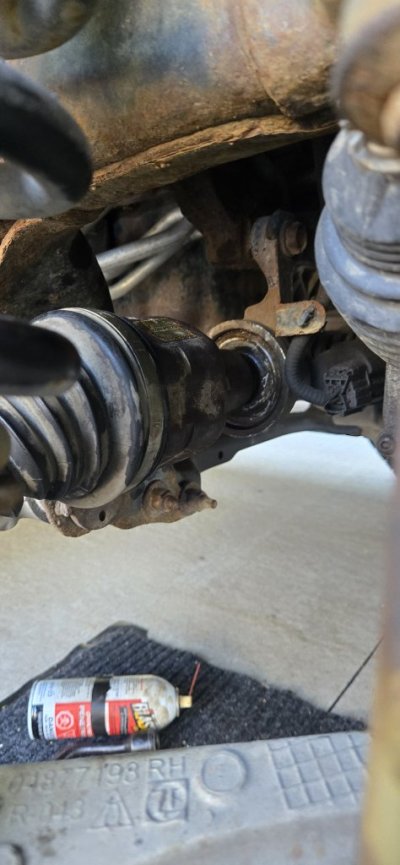

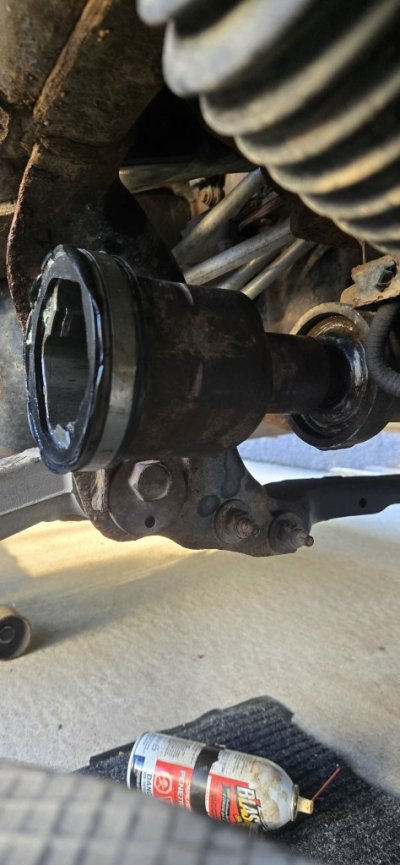

I'm at the final boss. Removing the passenger cv at the intermediate shaft. I've absolutely wailed on it with a hammer for an hour. I've tried using the cv shaft as a slide hammer but just seem to have dislocated the internals of the rear joint. This thing is absolutely not coming out.
Only idea left now is to cut the boot at that back joint and remove the length of shaft so it can at least drive in 2wd until I get more ideas.
Anyone?

Tnx for the reply. I may just cut the boot and remove all but the bell left on the stub. I saw some back and forth on the forums about how if the cv isn't bolted into the hub you can loose a wheel but I found a 2wd ram hub replacement video and looked like a 4x4 hub to me just no cv in the center. If that'll work for now I can go think on life and how to get this gd thing off.

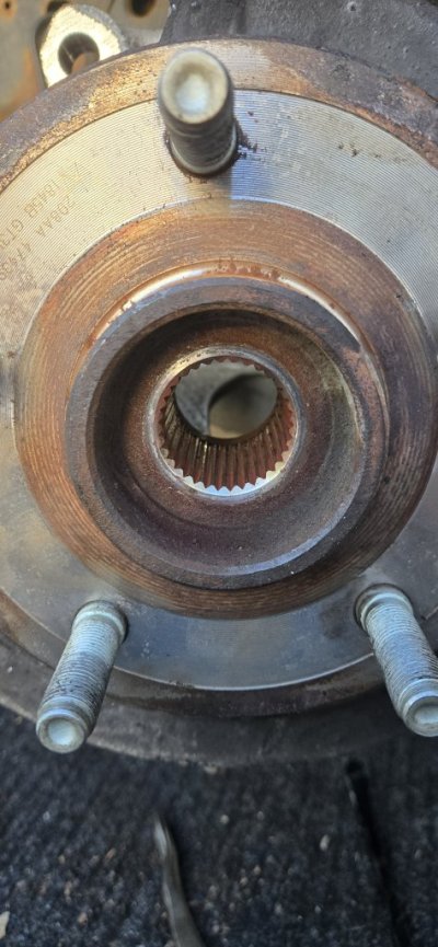

It'll stay as is until I can get some ideas and more tools. I double checked the hub bearing and dont see and seems anywhere that imply the hub nut and cv hold it together. I assume I won't lose the wheel first time I corner.
Doubtful,if that was the case the front wheels would of fell off my 4X4 10 years ago.The 2X4's and 4X4's use the exact same front hubs.
Odds are you probably need a new stub shaft,so you might want to split the front diff and tear it apart on a bench.

I did find the video linked above and have since got a HF air hammer. I'm going to hope that does it. Maybe the vibration and rapid knocking will bust it loose the way an impact wrench does. Just hoping it doesn't damage the aluminum housing as I have a hard time gauging how much force is being applied. Its just a 50$ harbor freight unit on a 20gal compressor so I think it's safe.
If the air hammer fails my next plan is to use an angle grinder, measure the dept of the cv female end on my new one, mark that depth on the old cv bell, use a cut off wheel to work my way around it until I can knock the bell off and expose the end of the stub shaft. At that point I'm thinking more PB and a 3 jaw pulled to try and coax the remaining "ring" of cv metal off. If that doesn't work then try and cut into the "ring" of metal to split it.
Finally. If all that fails, remove that side arm/shifter/intermediate shaft assembly and put it on the bench to amputate what i can and knock the shaft out and find a kit to replace it and the guts.
