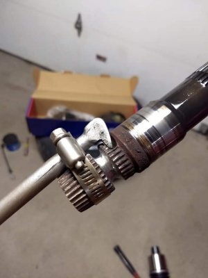

    7.) pull spindle out towards you, and remove the CV shaft threaded end...if its stuck and wint come out, you can try taking a pair of vise grips and taking off the nut that tightens them. Put a piece of all thread 3 feet long with a 4# sledge head running threw the middle of the all thread, and a nut and washer on the end thats big enough so the 4# head has something to hit against. (What you are making is a makeshift slide hammer).

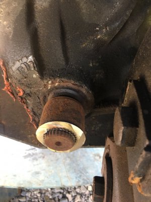

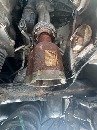

    8.) cut off CV axle shaft at 4” bell where it comes out of differential with a 6” wafer wheel on a grinder. (Be careful to nit cut into differential splines). Keep making small cuts and spinning bell to keep from cutting into splines. (Do not cut all the way thru). When you think you have less than a 3/32 of uncut bell material, start beating a chisel into the cut. It should break free the cut line and seperate.
    9.) remove CV bell and throw as far as you can (You will feel good at this point).

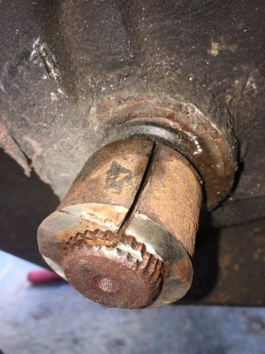

    10.) now that you just have a 3” shaft overtop of the splines, use a 1” cutoff wheel on a dremel and make two cuts on opposite ends. (Do not cut all the way thru).
    11.) when shaft cut has less than 3/32 smack it with a chisel and hammer. Cut line should break and seperate. If it doesnt, cut a little more and repeat.
    12. Remove one half of the cut shaft. Will pribably have to put truck in 4 wheel drive and then beat off other half shaft with a chisel.
